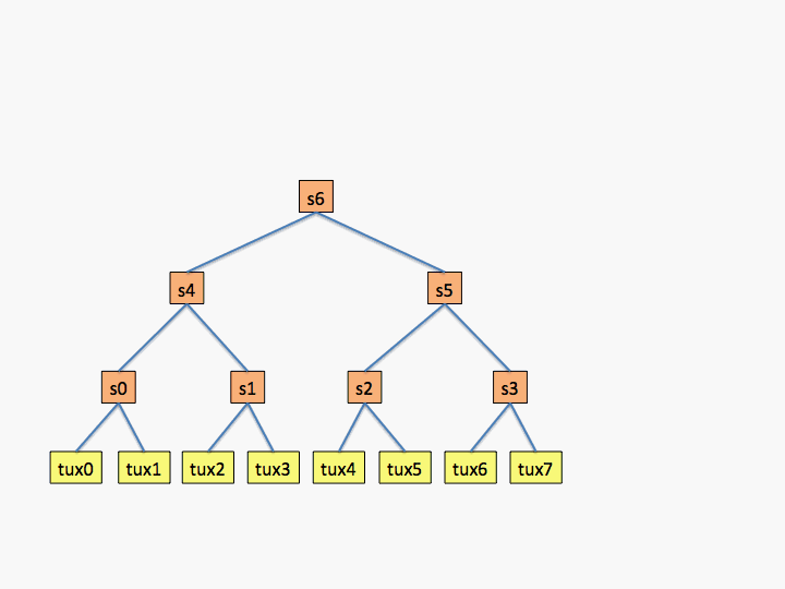

The first example shows what a topology would look like for an eight node cluster in which all switches have only two children as shown in the diagram (not a very realistic configuration, but useful for an example).
# topology.conf # Switch Configuration SwitchName=s0 Nodes=tux[0-1] SwitchName=s1 Nodes=tux[2-3] SwitchName=s2 Nodes=tux[4-5] SwitchName=s3 Nodes=tux[6-7] SwitchName=s4 Switches=s[0-1] SwitchName=s5 Switches=s[2-3] SwitchName=s6 Switches=s[4-5]
